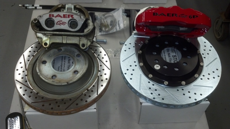

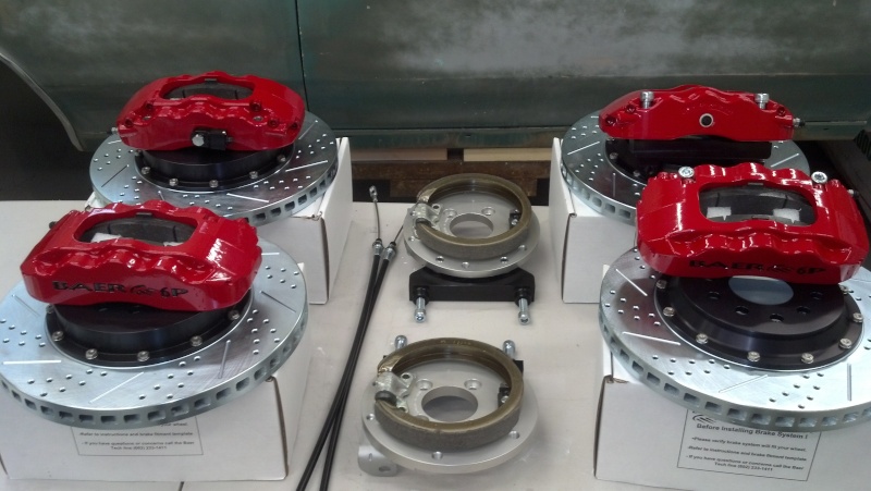

Brake upgrade time. While this is probably way overkill, I was definitely on the edge of the rear braking capabilities when doing the road coarse thing. Pretty sure this will solve that issue. More photos to come.

Those R nice. Look like 6 piston?

Yes. 6 Piston.
No. I converted from stock drums to a Baer Sport system (12" rotor) on the rear in 2009. The car stops great, but I was blowing through pads and rotors. Hoping upgrading to the 6 piston and 14" rotor does the trick.

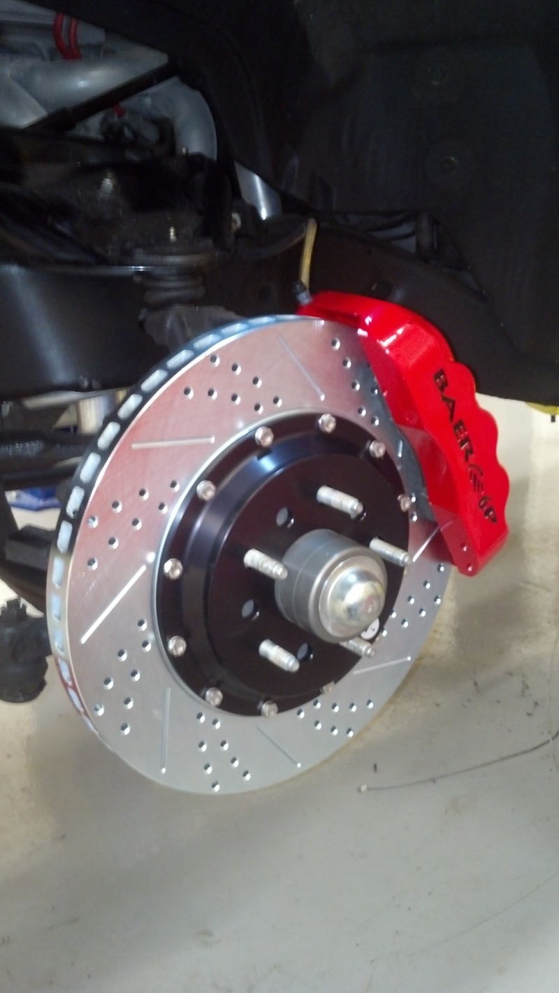

All new hardware has been installed. Just need to bleed the system and bed the pads.
Old front's vs. New fronts
Old rear caliper vs new rear pad:
New fronts installed:
Rear parking brake installed:
Rear caliper and rotor installed:
Front and rear:

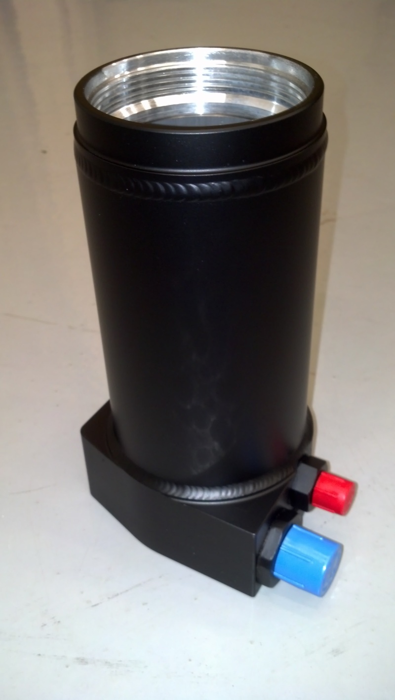

Upgrading the Power Steering as well. I went with a steering gear from Lee Engineering. Had to send them my type II p/s pump as well so they could upgrade the pressure it puts out to 1440psi. This gear has rack and pinion valving and the steering will feel like a new car does. There won't be any more play in the steering wheel, or wandering as you're driving straight down the road.
New Gear:
Decided to paint my remote PSC p/s reservoir so that it would match everything else. Forgot to take a photo before I started, but it was pretty ugly. Sanded it with 600 and then 1500.

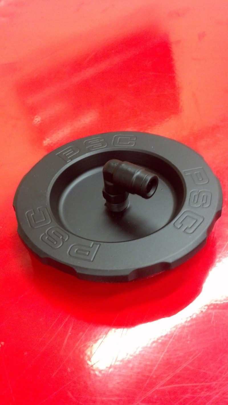

Installed. Still need to redo the cap. I'm going to mill off the vent, tap it for a -3 or -4AN fitting, and paint it black.
New Gear:

P/S Cap tapped for 1/8" npt and painted black.

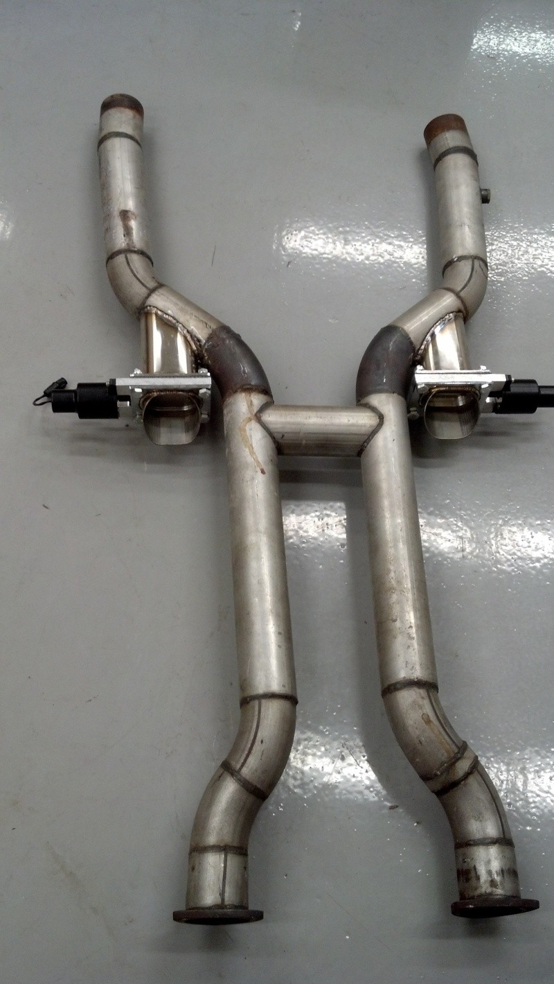

Loud? Yup....
Cut out the hole with the Plasma Cutter:
Pretty much as straight through as I could get it:
All welded up... Sure glad to have a good friend that TIG welds!

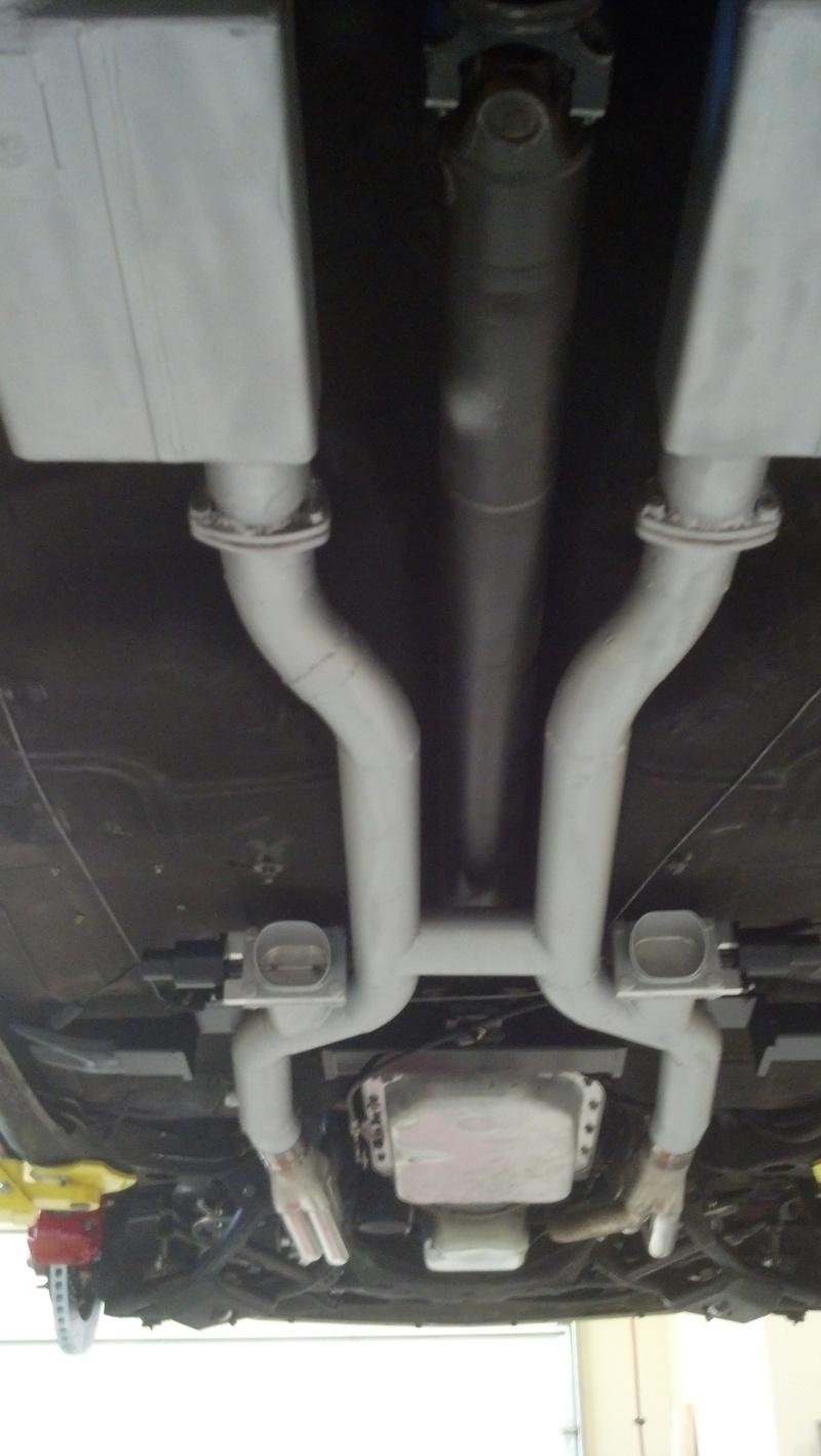

Painted:
Installed:
Painted:
Installed:

Cool. You'll have to post a high decibel vid. What did you coat the exhaust with?
Re: 74Malibu383 Build
I took video on my phone, but it turned out terrible. I'll see what I can do with the video camera. I used some of that VHT 2000 degree paint. We'll see how it holds up.
