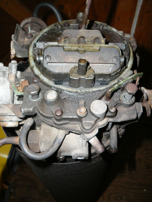

Messes up gaskets & gunks everything up with varnish if gas was left in it. Varshish build up is a PITA to deal with in all the nooks & crannies. I had my carb done @ a local guy in NH who does stuff from all over the place. Google Hobbs Carb in Pelham NH- he does nice work- won't be "show quality" but for $110.00 I can't complain. Carb was "pre-set" to factory specs also just bolted it on.
When my car is done (Lord willing) I think part of it's winter sabbatical will be removal & cleaning out the carb. Going to fab a cover for the air intake & just reinstall it nice & clean every spring.
(I don't wanna scare 2fat2fly with my "before pics" anymore -LOL....but this is what it looked like before & after the rebuild.
