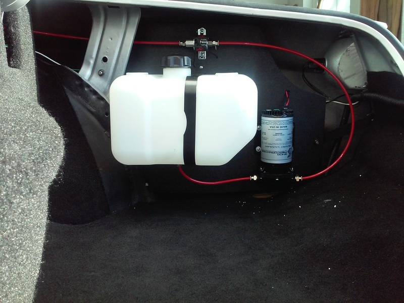

Some new equipment this year. I think we all have been waiting out the weather to get back "at it".
This year I decided to add a methanol system to cool the intake charge from my supercharger. I did entertain an intercooler. And it would have been cool to see a portion of big honkin' 5 " wide piece of pretty aluminum hanging below the radiator support on the front side.....But , IM RUNNING OUT OF ROOM...it seems. A couple of reasons I didn't intercool , room for all the piping and room for the intercooler as I have my front bumper tucked in. Also , within my research , intercooler could restrict air flow to the intake thus reducing boost and potential heat sink. Methanol will cool my intake charge up to 120 degrees and will require maint.(replenishment of the liquid in tank). But now I can reduce the retard I was running to prevent pre-detonation. I'm sure some opinions will be voiced between both options. Price for booth intercooler and associated parts and methanol kit was mostly the same money.
Below are some pictures finished product. I installed the unit in the trunk . I have a controller that I installed in the dash in the position where the factory clock use to be. The controller has telemetry for fluid level in the tank , amount of boost produced , parameters to set injection start .
All equipment was installed onto a piece of quarter inch ABS board. Made a couple of brackets from old gas tank strap to hold it in place. Painted them. All wiring is loomed on the back side with a quick connection through a weatherpak connection as is the connection behind my dash for the controller.
Had to cut a hole in my trunk enclosure that I made last year as the container is 2.5 gallons. I could have as well installed the supplied 3 quart unit...but I wanted more capacity.

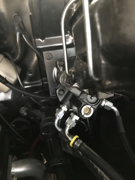

Hi fellow G3er’s ,
After the Power Tour….wanting to tackle a new project… I got to reading about the GM hydro-boost and decided….Im going do this retro- fit. I targeted my search to GM vehicles pre-2002 as that is what the rebuild kits suggest. First of all , what a difference in braking! This is the ticket for our 4000lb. range cars when it come to additional braking feel.
I went to the junkyard and found a year 2000 G2500 full size ¾ ton van and extracted the unit from it. Reason being , it already has the flat plate that attaches to the firewall so no need to remove the plate from the unit as with those from an Astro Van and then having to make or order aftermarket flat plate “ to make it work” on our cars. I do believe the full size pick-ups in the 2500 and 3500 variants work as well having the flat plate. For that matter , you could order one from Rock Auto already rebuilt for mid – eighties Oldsmobile 98’s with the Diesel option. And other GM offerings as well and according to what you want to spend for the rebuilt unit. As an example , I saw some for those mid-eighties diesel Old’s units in the sub $150.00 range ..no core needed!

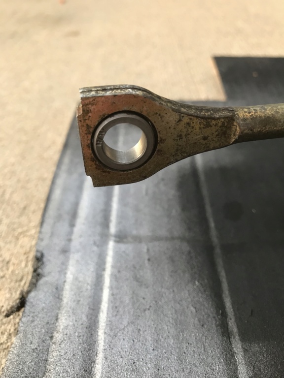

But , before I knew that , bought the rebuild a kit and rebuilt the unit on my bench. Approx 4 hours in the rebuild. Not hard as there is a ton of information on the web. No special tools. I decided to install mine upside down to hide the hydraulic lines. Or make them a somewhat less noticeable. A little more expense for the lines involved if going with this option. Factory lines can be used from mid-eighties GM diesel powered passenger cars too and cheaply to get up and running if installing in the factory orientation for less than $50.00.
I removed my vacuum booster and had to grind the rivets off it to harvest the bracket that is between the vacuum booster and firewall. This allowed me to continue to use my stainless brake lines to the master cylinder in their original length without altering. And puts the brake rod “straight in” to the brake pedal to prevent binding , just like with the factory vacuum booster. Also , during my “discovery” phase of the retro I found out that with the bracket attached to the factory vacuum booster and bracket attached to the hydro-boost unit….there is less than a 1/16 of an inch of difference to the front edge of the eyelet on the brake rods. So , same lengths…or close enough!
With this I got to thinking that I may not need to cut off the end of the brake rod on the hydro-boost and re-thread it to install an adjustable brake pedal clevis like I have read about on many do-it-yourself pages. After measuring , remeasuring. I went to the McMaster Carr catalog and found a hardened drill bushing ( part # 8491A364 ) to fill the void between the difference in size of the brake rod eyelet on the hydro boost as compared to the factory vacuum booster. The tolerances are spot on with drill bushing!
Most likely on any of the installs with the purchase of a late model unit as your base for hydro-boost, AN fittings will have to be used to connect your lines. I took my hydro boost unit along with the factory lines to a local shop so they could fit me up and make a couple of new lines. And I’m sorry guys , I do not have all the sizes for the fittings I used…and at the shop the guy said….” It will take too long to write up the ticket so…how about $80.00 for the lines and fittings”. Well OK!!! But again , all this information is on the net.
Also , for my set up , I did not run a “TEE” the return line. I ran a dedicated return to my PS reservoir from the Hydro-boost bypass port. For my power steering cooler , I retrieved a cooler from a mid 2000 Chevrolet truck. It is installed ahead of the core support on the driver's side on the truck. I installed in the same orientation on my core support and it is a "factory" looking fit. The hard lines on the cooler make a 90 degree turn towards the steering box...just like it "should" be there.
I was not willing to pay , from what I have seen , approx.. $650.00 range for “kits” to get into a hydro-boost. Here is a breakdown of my costs.
$32.00 , junkyard hydroboost
$15.00 Junkyard power steering cooler from mid 2000 Chevrolet truck. ( optional , but advised )
$25.00 Rebuild kit for Hydro.
$25.00 in line filter
$80.00 hoses and fittings ( 14 fittings , 2 hoses made)
$30.00 misc
Total :$207.00, and many hours research , install , figuring things out for a clean install.
Below , some pictures:
$30.00 misc
