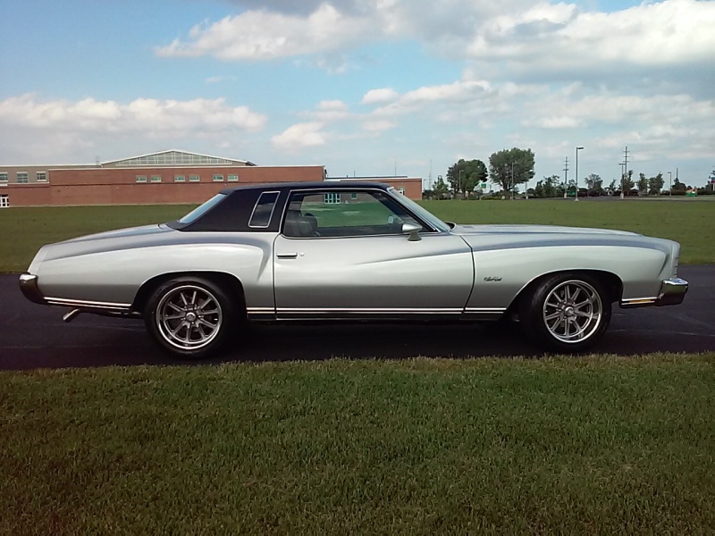

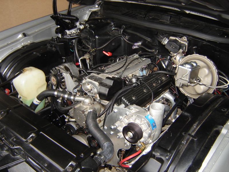

Able to get an early start this spring I updated my A/C to 134A . New condenser , Cycling POA , Trinary switch to control the elec. fans. All new hoses routed to be "mostly" hidden.
Cleaned up some odds and ends in the engine bay.
New wheels and tires.
18 x 9.5 rims , 255/50 tires.
May need to pull the front end down another 1".

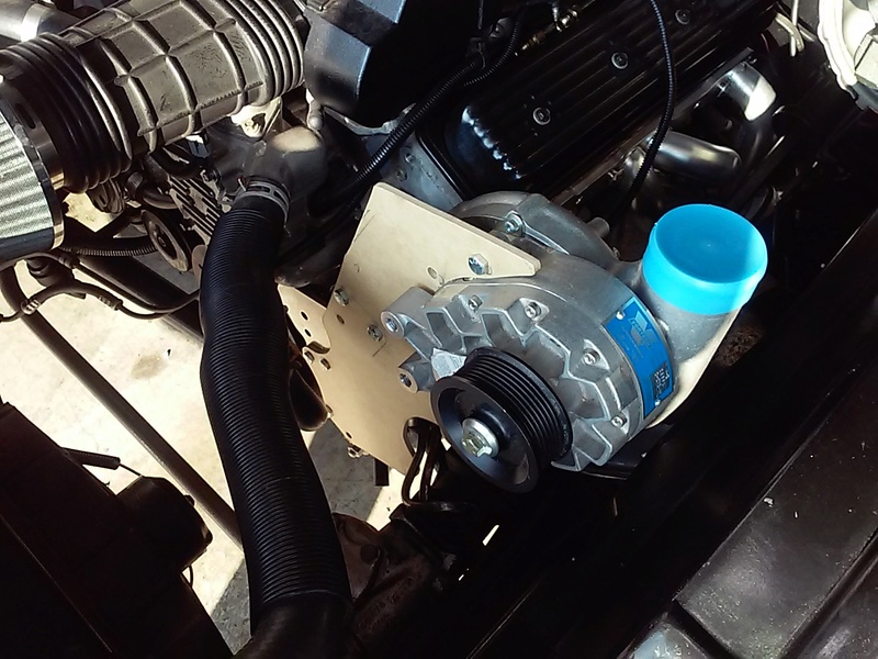

I knew I had been wanting a supercharger but didn't know I would find one as a kit specifically for my LT1. I had been watching Ebay and seeing pieces and parts.... nothing complete...and everything well used. Then I am searching around on CL anything east of the Mississippi with "supercharger" as the search. Then low and behold I find one ! A guy had a 95 Camaro...bought a supercharger kit for his LT1...and sold the car. Now present day. He decides to sell the kit which includes the unit , all hardware , belts , hoses , fuel management unit , ignition system , pulleys, harmonic balancer , installation manuals , all for what I've been seeing the "supercharger only" units go for. So , now , the kit is for a F-BODY car. I am having to create a bracket to attach the unit to the engine. With the F-BODY brackets the supercharger unit is low on engine and our car being an A-BODY would put that supercharger where our power steering box is located.
Here is my progress from cardboard to rigid fiberboard....now I have to order my aluminum. I have ten hours so far figuring out this piece of things....

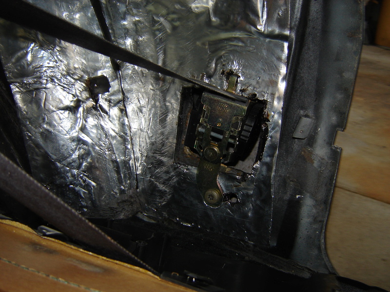

While installing the rear package tray I had to take apart a better part of one side of the rear interior. A couple of years ago I updated the seat belts to units from a 2000-2005 Monte Carlo. The early 3-point seat belt system is very cumbersome.
At the time I documented but did not post.
There is a square hole I utilized by opening it up a little more to insert the assembly. I tilted the unit slightly to aim it towards the connection point at the top of the B-pillar.
Now , onto an update of my supercharger install.
I hid my ignition box in the cowl on the driver's side just behind the pwr brake booster. I have a quarter inch of clearance at the front corner of the box as the wiper motor rod in the cowl rotates. I brought the wiring out through the firewall just to the right of the wiper motor on the firewall.
Transferred the fiberboard template from my previous post to now brushed aluminum to hang the supercharger...
Now have a couple of vacuum lines to run...one being to the blow off valve. And I have to install an intake tube for fresh air to the supercharger and discharge tube to the intake...
