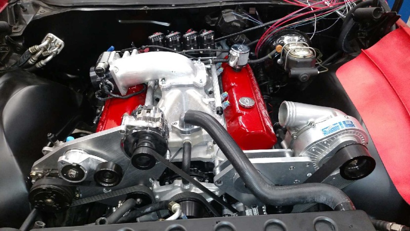

Boost:

Been plugging away slowly. Shocking... nothing fits. Couldn't find any headers off the shelf that fit very well. They all hung down way too low. So, I gave Dan Lemons a call at Lemons headers. He was awesome. He built a set of 2 1/8" headers and tacked them for me. After install, there were a few tubes that hit pretty bad. So, I cut a bunch of holes and slots in them, took a bunch of photos and sent them back. He made the requested modifications, still only tack welded them, and back to me for round 2. They were super close to fitting at this point, so I requested a couple more changes. Round 3 fit great, so I sent them back to him for a final weld. Talk about doing a great job. Wish I could weld like this guy!!!! He even beveled the edges of every tube at the collector and the flange.
So.... Here's some header porn for you! Photos don't do them justice. They are super nice.

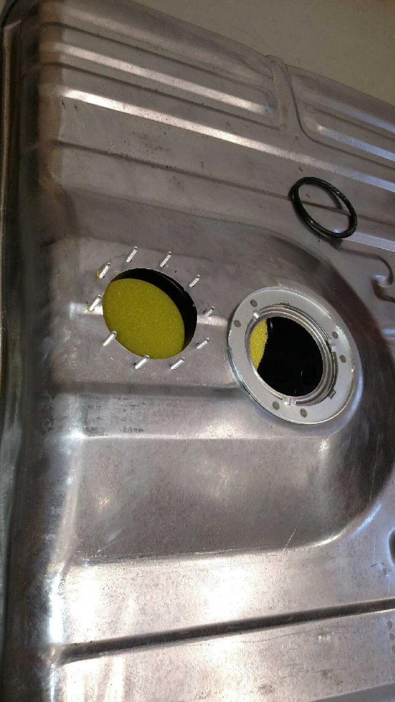

Been a while since I've posted, but here's a quick up date.
- Took the 572 out and sent it over to the engine shop for some ARP2000 studs and bolts to be installed.
- Drilled and installed bungs for the injectors in the intake, and had some custom fuel rails made.
- Installing a 28 circuit Painless Wiring harness (I would say slightly more than painless.....)
- Installed power windows.
- Installing the Dominator ECU with DIS system. (This is an awesome piece, but it is a ton of work.)
- Installed an Aeromotive Dual Stealth Fuel system into a new fuel tank.
- Upgraded fuel line to mostly 1/2" hardline and PTFE hose from tank to hardline, and hardline to fuel rails.
- Installing a VaporWorx fuel controller to run a returnless fuel system.

Brian I think I speak for a lot guys/gals here when I say I cant wait to see this Beast fire up again with this new set up !
Re: 74Malibu383 Build
That's gonna be awesome. Thirsty, but awesome.
Thanks you! Yes, most likely going to be pretty thirsty. Hoping the fuel injection helps when cruising, but not holding my breath.
