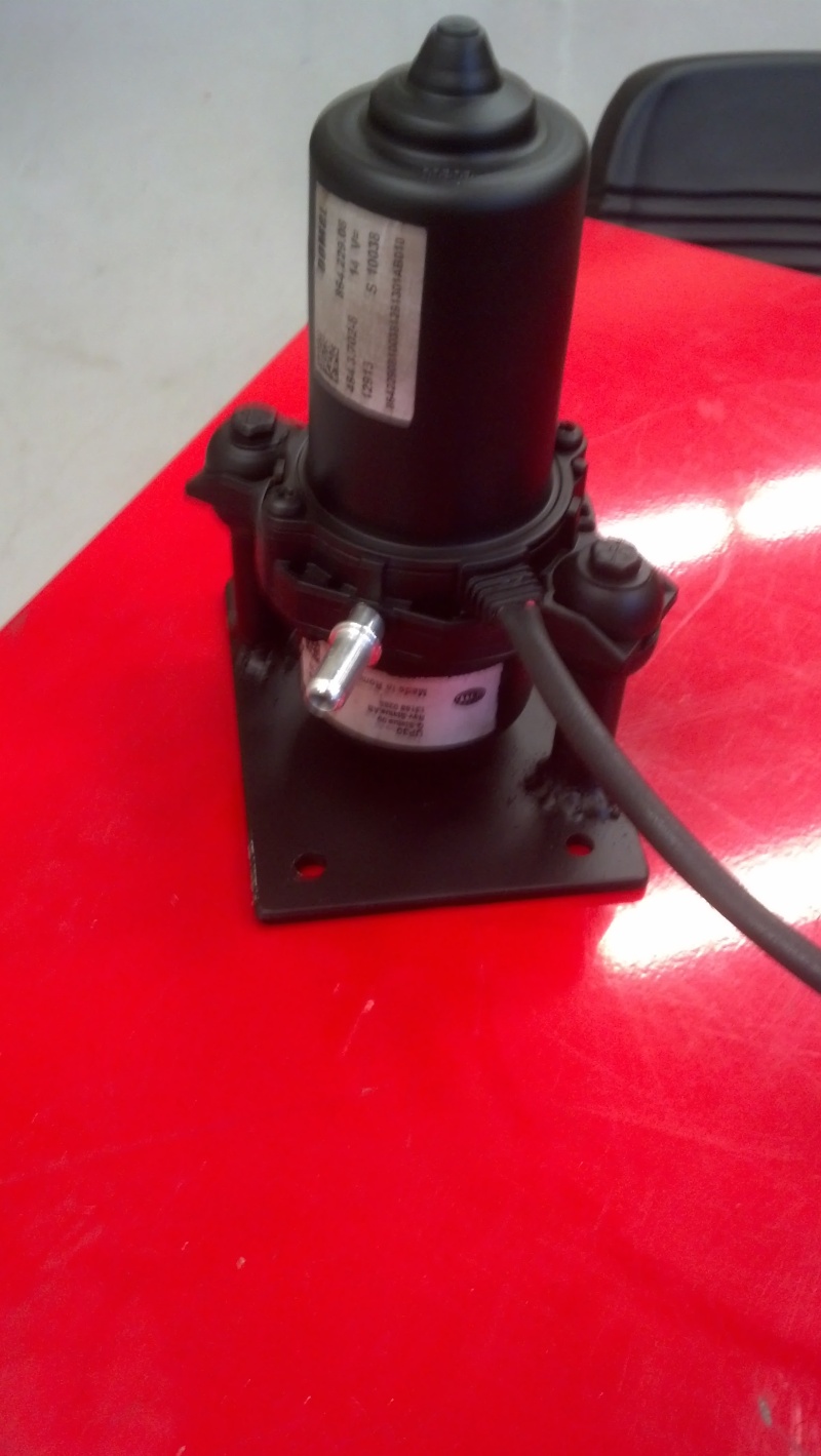

Ever since the engine rebuild, I've only been making 10-12in of vacuum. My brakes have worked ok, but I thought they could be better. After some research on some electric car forums, I found a lot of people were running Hella UP28 or UP30 vacuum pumps to give them power brakes. I opted for the UP30 as it was tested at a much higher number of cycles. I made a little bracket, bolted it up under the driver fender, and plumbed it into my brake booster vacuum circuit. When I plumbed it in, I made sure to tap into the existing manifold vacuum so that if the pump were to go out, I would still have power brakes at the original 10-12in of vacuum. I used an adjustable vacuum operated Hobbs switch to give me 22in of vacuum and wired it in. The pump turns on when it senses vacuum below 16" and turns off at 22". The brakes felt great, and during an unforeseen panic moment somewhere outside of Jackson Mississippi, they saved me from the junk yard. Some crazy chick didn't even look when merging 4 lanes over! Sure wish I had that on video....
Pump and stand:
74Malibu383 Build - Page 5 Img_2011
Painted:
74Malibu383 Build - Page 5 Img_2012

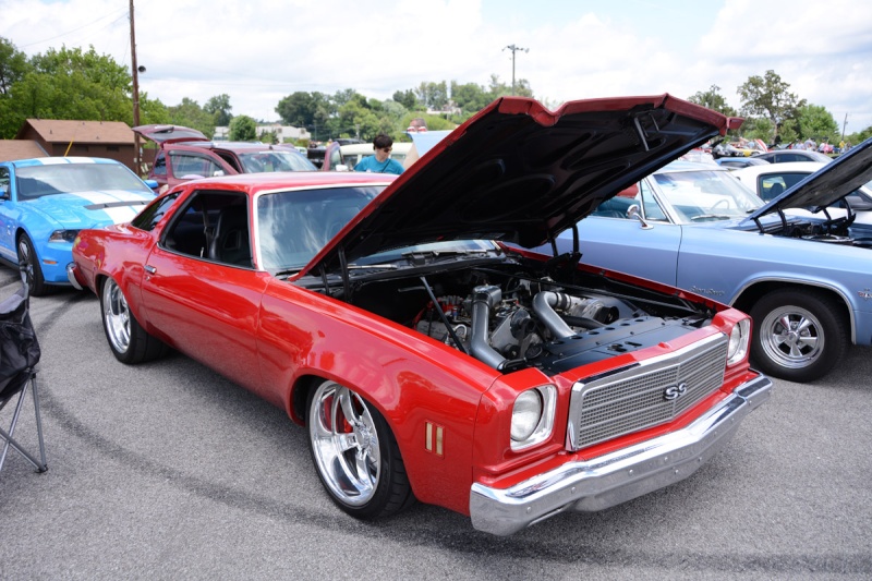

Post by 74Malibu383 Thu Jul 31, 2014 8:07 am
Found these on Bangshift...
http://bangshift.com/general-news/event-coverage/hot-rod-power-tour-2014-day-2-coverage-knoxville-tennessee-collection-coolest-stuff/
74Malibu383 Build - Page 5 Car_kn10
74Malibu383 Build - Page 5 Engine10
