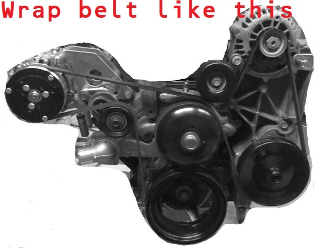

Im going with this bracket set up for A/C I have not tried to mount it yet still working on other stuff.
It may work or not as my set up is all different from front running accessories.
