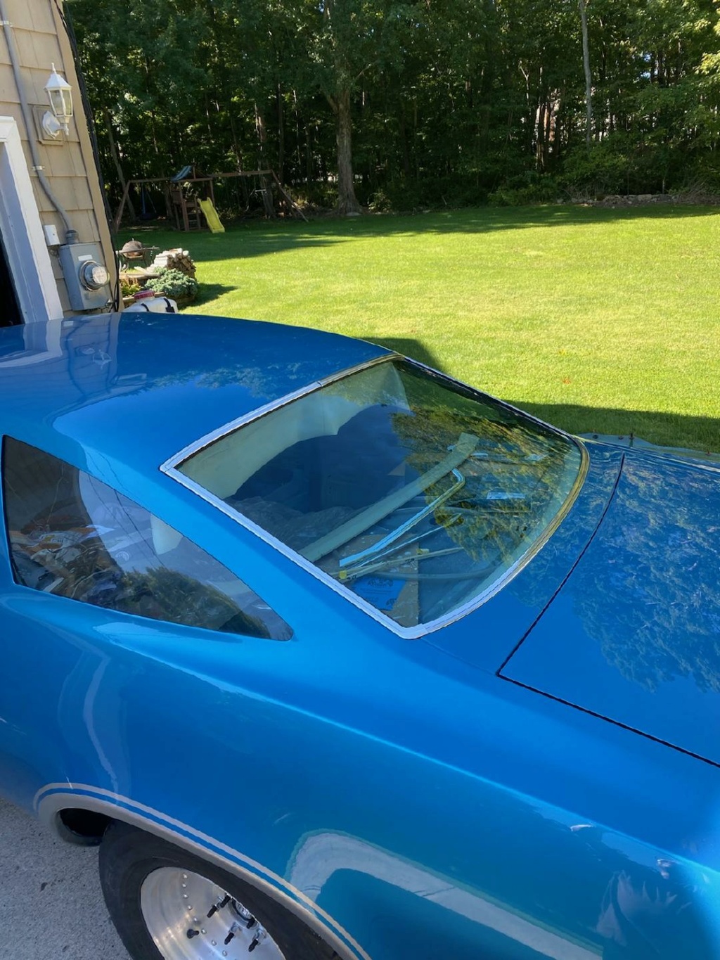

Ok, finally got around to polishing my door glass but I havent installed them yet. Decided to install my back glass and trim. Did a trial fit by laying it in place with the rubber blocks on the bottom. Decided that 3/8" butyl would be fine but I'd have to squish it down a bit more. So I decided to use 5/16" butyl. Im installing my original factory glass. I cleaned the pinch weld good with some wax and grease remover and same with the glass. Ran the butyl around the pinch weld flush with the edge. Already had some tape on the top and bottom as "witness marks" to make lining it up easier. I set the glass right into place and it met with the butyl almost everywhere. Some slight pressing on the glass and everything was in contact. I put some tape around the body edge, just in case, while installing the trim. The trim clicked into place with no issues and its flush with the body. Im happy with it. Hoping to grab a new windshield in the near future.

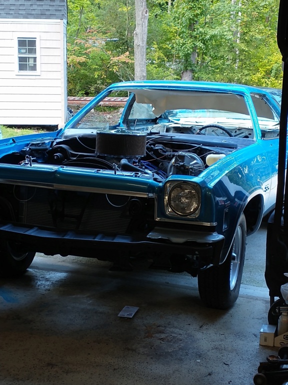

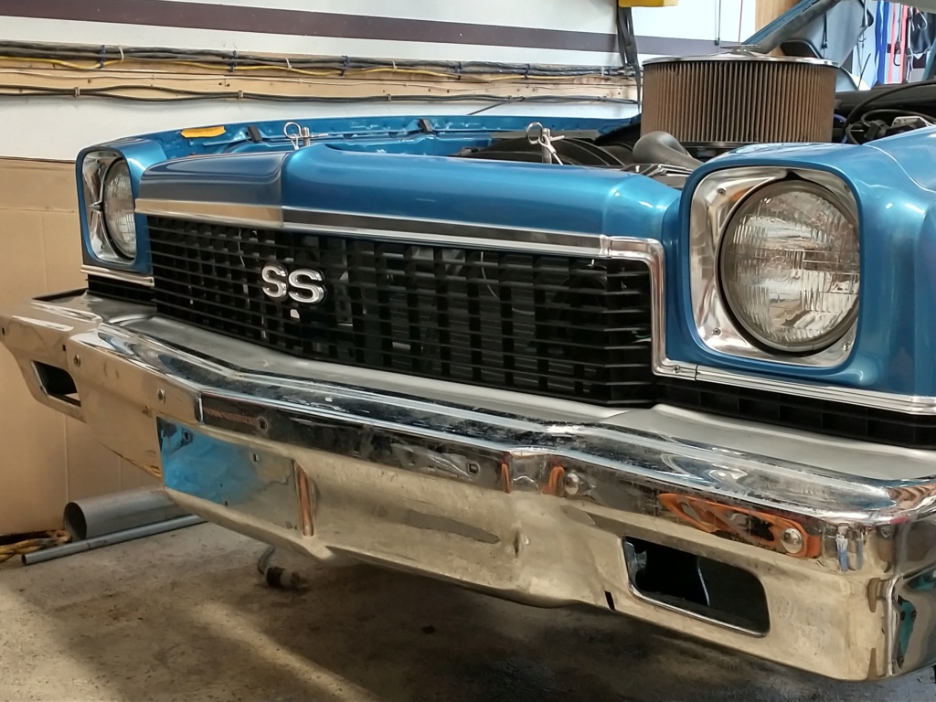

Then I installed all the front bumper hardware and brackets minus the chrome. Its alot of pieces. Had a buddy come by to hold things in place while I tightened things up. I left the 8 verticle adjustment bolts hand tight so I can line it up with the grill. Popped the grill in, checked the gaps and tightened it up. No issues and came out nice.

Nice work as usual, Joe!
Interesting to read which thickness butyl tape you ended up using on the rear glass. I researched the process on a number of forums and could never find a general consensus on whether to use 5/16" or 3/8" butyl...no matter whether using original factory glass or aftermarket. Then, of course, there were those who insisted that urethane sealant was the only way to go. Nice to hear results from someone who's work I can respect.
Re: 1973 Chevelle SS, 350, 4spd. build
Thanks Ant, thanks Steve. 3/8" wouldnt be a problem, just need to squish it a bit more. 5/16" worked well for me with factory glass. I have a new roll of 3/8" that I will be using on the windshield.

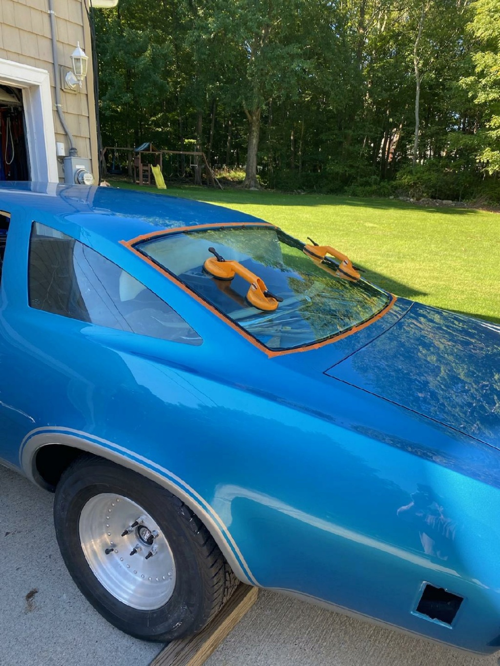

Picked up the windshield this morning. Drove down to NYC to a place I know that can order the glass on the spot. Waited 45 minutes and it arrived. I paid $175 cash for it. Ive been seeing prices on the net at around $190-$225 PLUS shipping. Some shipping was as high as $190 !!.
Part number is DW00803. Blue/green shaded top with antenna. If you google it, National Parts Depot in North Carolina has it on sale for $51. For shipping to NY they want $225 so that was out of the question. But if someone is close to there, its a great deal!!!!
I laid it in place and it will definitely require 3/8" butyl for a flush fit. Hope to install it within the next week.

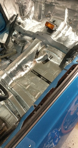

Havent had a chance to install the windshield yet. Decided to install the GTmat Ultra on the floor. Took quite a while to do it. Vacuumed the floor, wiped it down with wax and grease remover, let it air dry for awhile then I started. Not hard at all to do, just time consuming. Im not going to do the doors. Just the floor.
- Street Cred : 80
looking good! That stuff makes a world of difference.
